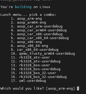

设置环境变量
./build/envstep.sh
lunch
box -> rk3328_box
atv -> rk3328
