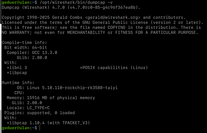

    查看dumpcap信息
    /opt/wireshark/bin/dumpcap -v

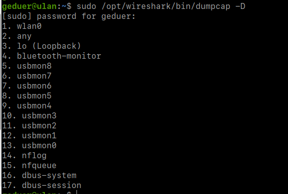

    确认目前能识别哪些设备
    newgrp wireshark
    sudo /opt/wireshark/bin/dumpcap -D

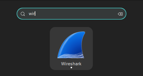

    按win键搜索wireshark

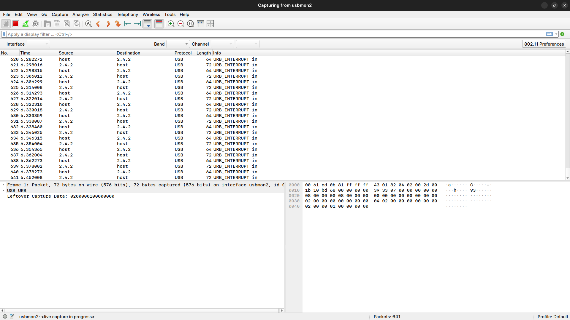

  3. 重启电脑,验证抓包功能(图中以usb抓包为例)
