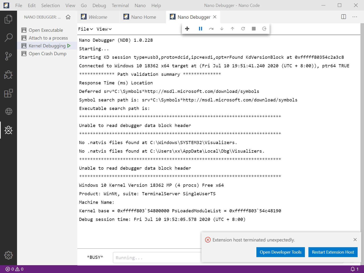

设置了环境变量以后,用nanocode链接gdk7还是有错误:
Nano Debugger (NDB) 1.0.228 Starting... Starting KD session type=usb3,proto=dcid,ipc=exdi,opt=rFound KdVersionBlock at 0xfffff8037c02a3d8 Connected to Windows 10 18362 x64 target at (Fri Jun 19 13:08:30.711 2020 (UTC + 8:00)), ptr64 TRUE *** Path validation summary *** Response Time (ms) Location Deferred srvC:\Symbolshttps://msdl.microsoft.com/download/symbols Symbol search path is: srvC:\Symbols*https://msdl.microsoft.com/download/symbols Executable search path is:
Unable to read debugger data block header
No .natvis files found at C:\Windows\SYSTEM32\Visualizers. No .natvis files found at C:\Users\xx\AppData\Local\Dbg\Visualizers.
Windows 10 Kernel Version 18362 MP (4 procs) Free x64 Product: WinNt, suite: TerminalServer SingleUserTS Machine Name: Kernel base = 0xfffff8037bc00000 PsLoadedModuleList = 0xfffff8037c048170 Debug session time: Fri Jun 19 13:08:37.692 2020 (UTC + 8:00)
这个是什么原因导致的?
Comments
看着挺正常了,你说错误是指那句话?
gdman gravatar image gdman  ( 2020-06-19 17:07:23 +0800 ) edit
我在上面补充了一个图片,打印上面的信息之后,控制台退出了。
yafare gravatar image yafare  ( 2020-07-10 19:55:23 +0800 ) edit
从上面截图看,你用的是exdi方式,建议换dci open方式试一下,另外,你用的是比较旧的版本,https://www.nanocode.cn/#/download 有新版本了
gdman gravatar image gdman  ( 2020-07-11 08:37:18 +0800 ) edit
