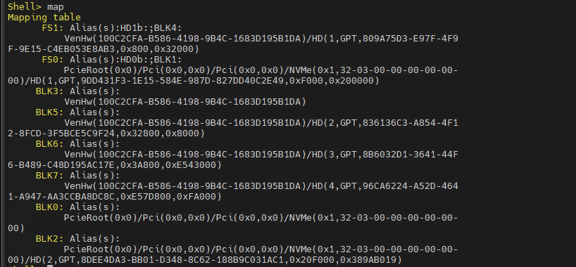

Shell: map & dblk
2024.05.07
重新排序:
UEFI v2.70 (EDK II, 0x00010000)
Mapping table
     BLK0: Alias(s):              PcieRoot(0x0)/Pci(0x0,0x0)/Pci(0x0,0x0)/NVMe(0x1,32-03-00-00-00-00-00-00)
     FS0: Alias(s):HD0b:;BLK1:    PcieRoot(0x0)/Pci(0x0,0x0)/Pci(0x0,0x0)/NVMe(0x1,32-03-00-00-00-00-00-00)/HD(1,GPT,9DD431F3-1E15-584E-987D-827DD40C2E49,0xF000,0x200000)
     BLK2: Alias(s):              PcieRoot(0x0)/Pci(0x0,0x0)/Pci(0x0,0x0)/NVMe(0x1,32-03-00-00-00-00-00-00)/HD(2,GPT,8DEE4DA3-BB01-D348-8C62-188B9C031AC1,0x20F000,0x389AB019)
     BLK3: Alias(s):              VenHw(100C2CFA-B586-4198-9B4C-1683D195B1DA)
     FS1: Alias(s):HD1b:;BLK4:    VenHw(100C2CFA-B586-4198-9B4C-1683D195B1DA)/HD(1,GPT,809A75D3-E97F-4F9F-9E15-C4EB053E8AB3,0x800,0x32000)
     BLK5: Alias(s):              VenHw(100C2CFA-B586-4198-9B4C-1683D195B1DA)/HD(2,GPT,836136C3-A854-4F12-8FCD-3F5BCE5C9F24,0x32800,0x8000)
     BLK6: Alias(s):              VenHw(100C2CFA-B586-4198-9B4C-1683D195B1DA)/HD(3,GPT,8B6032D1-3641-44F6-B489-C48D195AC17E,0x3A800,0xE543000)
     BLK7: Alias(s):              VenHw(100C2CFA-B586-4198-9B4C-1683D195B1DA)/HD(4,GPT,96CA6224-A52D-4641-A947-AA3CCBA8DC8C,0xE57D800,0xFA000)

BLK0:          为一块硬盘;
FS0:HD0b:BLK1: 第一个GPT分区,可识别的文件系统,开始扇区号为0xF000,扇区数为0x200000;
BLK2:          为第二个GPT分区,开始扇区号为0x20F000,扇区数为0x389AB019。

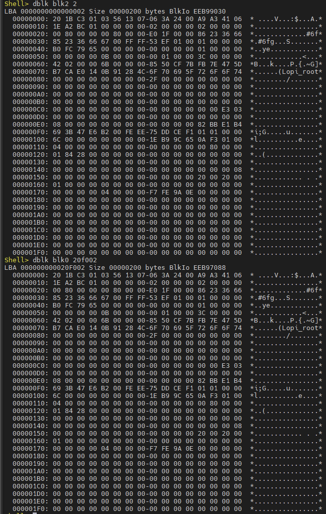

dblk 命令通过访问BLK0可以等效访问BLK1或BLK2,只是开始的扇区号相应调整,请看下面例子:

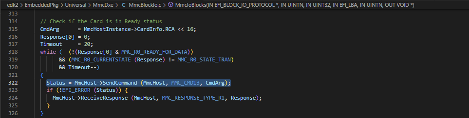

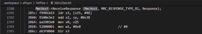

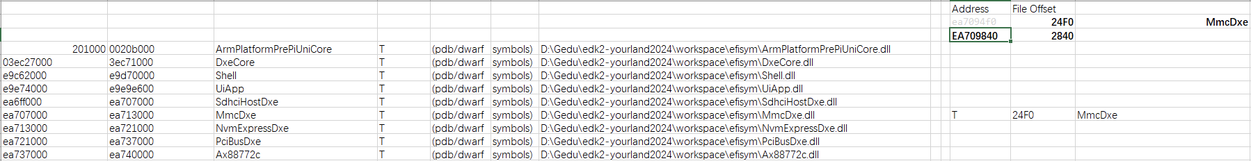

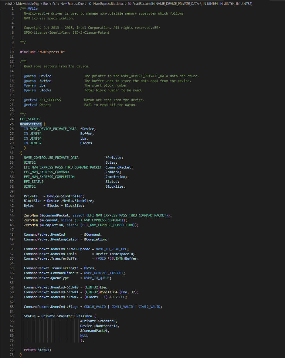

dblk命令是如何读取扇区的?读源代码,再上NDB观察(原过程没有这么顺利,因为发现有代码没有符号,现已经加载上):
参阅:lm及观察加载的Modules
可以观察到,这里有两块硬盘,访问硬盘时,直接用NvmExpressDxe和MmcDxe驱动,访问分区的扇区,则用PartitionDxe:

dqs 0`EEB97088 l30/8
00000000`eeb97088  00000000`00020001
00000000`eeb97090  00000000`eeb97058
00000000`eeb97098  00000000`ea71923c NvmExpressDxe!NvmeBlockIoReset
00000000`eeb970a0  00000000`ea717078 NvmExpressDxe!NvmeBlockIoReadBlocks
00000000`eeb970a8  00000000`ea71732c NvmExpressDxe!NvmeBlockIoWriteBlocks
00000000`eeb970b0  00000000`ea715968 NvmExpressDxe!NvmeBlockIoFlushBlocks

FS1:\> dblk blk2
LBA 0000000000000000 Size 00000200 bytes BlkIo EEB99030
  00000000: 00 00 00 00 00 00 00 00-00 00 00 00 00 00 00 00  *................*

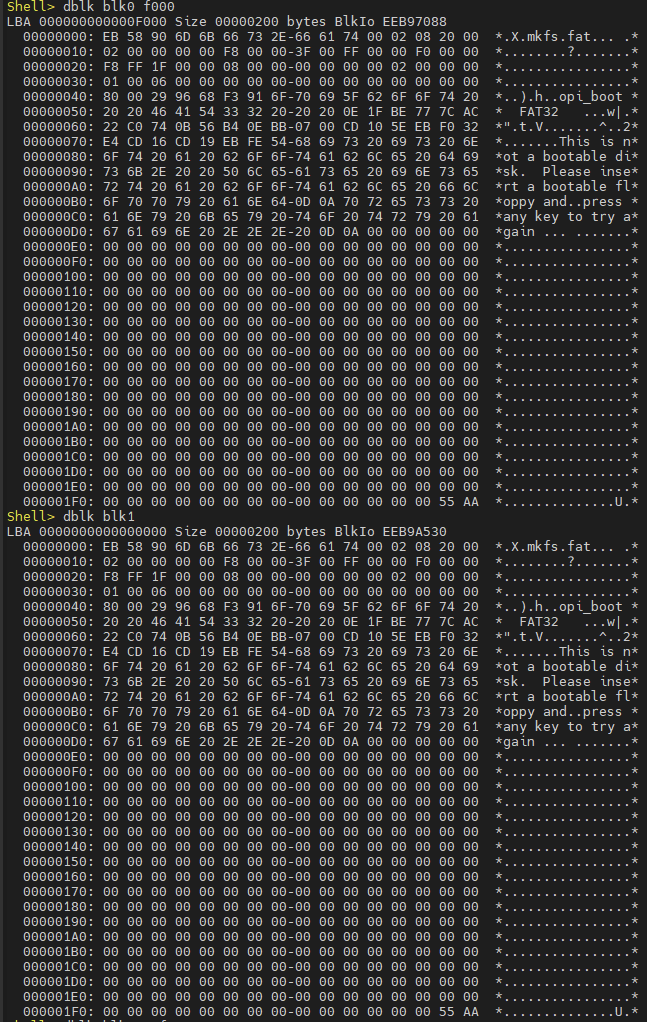

FS1:\> dblk blk7
GDDBG MMCSendCommand without IgnoreCommand
GDDBG MMCSendCommand will exit
SdhciSoftReset with mask 0x6000000
GDDBG MMCReadBlockData will exit
LBA 0000000000000000 Size 00000200 bytes BlkIo EF1A0030
  00000000: EB 52 90 4E 54 46 53 20-20 20 20 00 02 08 00 00  *.R.NTFS    .....*
  00000010: 00 00 00 00 00 F8 00 00-3F 00 FF 00 00 D8 57 0E  *........?.....W.*
  00000020: 00 00 00 00 80 00 80 00-FF 9F 0F 00 00 00 00 00  *................*
  00000030: AA A6 00 00 00 00 00 00-02 00 00 00 00 00 00 00  *................*
  00000040: F6 00 00 00 01 00 00 00-FE C4 7D 08 00 7E 08 30  *..........}..~.0*
  00000050: 00 00 00 00 FA 33 C0 8E-D0 BC 00 7C FB 68 C0 07  *.....3.....|.h..*
  00000060: 1F 1E 68 66 00 CB 88 16-0E 00 66 81 3E 03 00 4E  *..hf......f.>..N*
  00000070: 54 46 53 75 15 B4 41 BB-AA 55 CD 13 72 0C 81 FB  *TFSu..A..U..r...*
  00000080: 55 AA 75 06 F7 C1 01 00-75 03 E9 DD 00 1E 83 EC  *U.u.....u.......*
  00000090: 18 68 1A 00 B4 48 8A 16-0E 00 8B F4 16 1F CD 13  *.h...H..........*
  000000A0: 9F 83 C4 18 9E 58 1F 72-E1 3B 06 0B 00 75 DB A3  *.....X.r.;...u..*
  000000B0: 0F 00 C1 2E 0F 00 04 1E-5A 33 DB B9 00 20 2B C8  *........Z3... +.*
  000000C0: 66 FF 06 11 00 03 16 0F-00 8E C2 FF 06 16 00 E8  *f...............*
  000000D0: 4B 00 2B C8 77 EF B8 00-BB CD 1A 66 23 C0 75 2D  *K.+.w......f#.u-*
  000000E0: 66 81 FB 54 43 50 41 75-24 81 F9 02 01 72 1E 16  *f..TCPAu$....r..*
  000000F0: 68 07 BB 16 68 52 11 16-68 09 00 66 53 66 53 66  *h...hR..h..fSfSf*
  00000100: 55 16 16 16 68 B8 01 66-61 0E 07 CD 1A 33 C0 BF  *U...h..fa....3..*
  00000110: 0A 13 B9 F6 0C FC F3 AA-E9 FE 01 90 90 66 60 1E  *.............f`.*
  00000120: 06 66 A1 11 00 66 03 06-1C 00 1E 66 68 00 00 00  *.f...f.....fh...*
  00000130: 00 66 50 06 53 68 01 00-68 10 00 B4 42 8A 16 0E  *.fP.Sh..h...B...*
  00000140: 00 16 1F 8B F4 CD 13 66-59 5B 5A 66 59 66 59 1F  *.......fY[ZfYfY.*
  00000150: 0F 82 16 00 66 FF 06 11-00 03 16 0F 00 8E C2 FF  *....f...........*
  00000160: 0E 16 00 75 BC 07 1F 66-61 C3 A1 F6 01 E8 09 00  *...u...fa.......*
  00000170: A1 FA 01 E8 03 00 F4 EB-FD 8B F0 AC 3C 00 74 09  *............<.t.*
  00000180: B4 0E BB 07 00 CD 10 EB-F2 C3 0D 0A 41 20 64 69  *............A di*
  00000190: 73 6B 20 72 65 61 64 20-65 72 72 6F 72 20 6F 63  *sk read error oc*
  000001A0: 63 75 72 72 65 64 00 0D-0A 42 4F 4F 54 4D 47 52  *curred...BOOTMGR*
  000001B0: 20 69 73 20 63 6F 6D 70-72 65 73 73 65 64 00 0D  * is compressed..*
  000001C0: 0A 50 72 65 73 73 20 43-74 72 6C 2B 41 6C 74 2B  *.Press Ctrl+Alt+*
  000001D0: 44 65 6C 20 74 6F 20 72-65 73 74 61 72 74 0D 0A  *Del to restart..*
  000001E0: 00 00 00 00 00 00 00 00-00 00 00 00 00 00 00 00  *................*
  000001F0: 00 00 00 00 00 00 8A 01-A7 01 BF 01 00 00 55 AA  *..............U.*

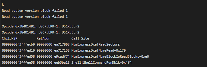

dblk blk0的调用栈:
dblk blk3:
00000000`3fffed58 00000000`e9cadf74 MmcDxe!MmcIoBlocks
00000000`3fffee58 00000000`eeb38a18 Shell!ShellCommandRunDblk+0x4f4
dblk blk1:
00000000`3fffec00 00000000`ea717068 NvmExpressDxe!ReadSectors
00000000`3fffec60 00000000`ea717158 NvmExpressDxe!NvmeRead+0x170
00000000`3fffeca8 00000000`ea973e10 NvmExpressDxe!NvmeBlockIoReadBlocks+0xe0
00000000`3fffeda8 00000000`00000000 DiskIoDxe!DiskIo2ReadWriteDisk+0x340 [/home/geduer/UEFI/edk2-yourland2024/edk2/MdePkg/Library/BaseDebugLibSerialPort/DebugLib.c @ 945]
dblk blk4:
00000000`3fffeca8 00000000`ea973e10 MmcDxe!MmcIoBlocks

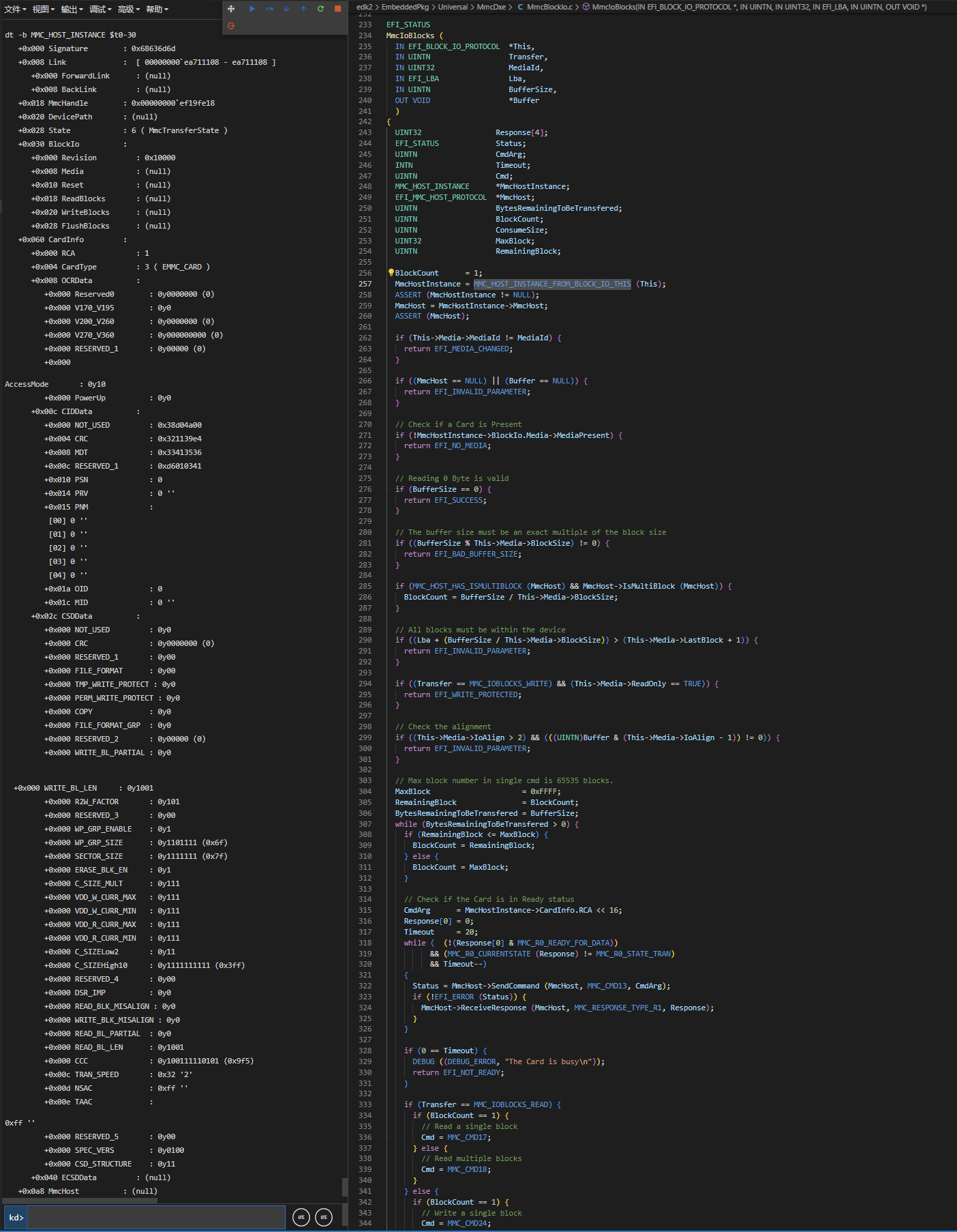

从MmcDxe!MmcIoBlocks 再往下深一层,看MmcHost到底是哪个,依然是用NDB下断点:
从list文件搜索到文件偏移位置:
自建Excel查找,从文件偏移算出断点地址:
断点命中,停下来观察:
MmcDxe!MmcIoBlocks+350:
ea709840 f9401723 ldr    x3, [x25, #0x28]
u .
Read system version block failed 1
Opcode 0x38401401, DSCR.ERR=1, DSCR.EL=2
ea709844 528001a1 mov    w1, #0xd
ea709848 2a1303e2 mov    w2, w19
ea70984c aa1903e0 mov    x0, x25
ea709850 72a00021 movk    w1, #1, lsl #16
ea709854 d63f0060 blr    x3
ea709858 b7fff1e0 tbnz    x0, #0x3f, #0xea709694
ea70985c f9401b23 ldr    x3, [x25, #0x30]
r $t0=x25
dt -b EFI_MMC_HOST_PROTOCOL $t0
   +0x000 Revision         : 0x10002
   +0x008 IsCardPresent    : (null)
   +0x010 IsReadOnly       : (null)
   +0x018 BuildDevicePath  : (null)
   +0x020 NotifyState      : (null)
   +0x028 SendCommand      : (null)
   +0x030 ReceiveResponse  : (null)
   +0x038 ReadBlockData    : (null)
   +0x040 WriteBlockData   : (null)
   +0x048 SetIos           : (null)
   +0x050 IsMultiBlock     : (null)
dqs $t0 l58/8
00000000`ea705020  00000000`00010002
00000000`ea705028  00000000`ea700018 SdhciHostDxe!MMCIsCardPresent
00000000`ea705030  00000000`ea701054 SdhciHostDxe!MMCIsReadOnly
00000000`ea705038  00000000`ea70316c SdhciHostDxe!MMCBuildDevicePath
00000000`ea705040  00000000`ea70266c SdhciHostDxe!MMCNotifyState
00000000`ea705048  00000000`ea701798 SdhciHostDxe!MMCSendCommand
00000000`ea705050  00000000`ea7015e4 SdhciHostDxe!MMCReceiveResponse
00000000`ea705058  00000000`ea702c18 SdhciHostDxe!MMCReadBlockData

bl
 0 e 00000000`ea7094f0 e 1 0001 (0001) MmcDxe!MmcIoBlocks
 1 e 00000000`ea709840 e 1 0001 (0001) MmcDxe!MmcIoBlocks+350
r
 x0=0000000000000000  x1=00000000ef19b618  x2=000000000e678000  x3=0000000000000000
 x4=0000000000000200  x5=00000000eeb29118  x6=000000003ec2c950  x7=ffffffffffffffff
 x8=0000000000000000  x9=0000000000000062 x10=0064006300320069 x11=0000000000000020
x12=0000000000000000 x13=ffffffff00000000 x14=006b0072006f0077 x15=00630061003b0031
x16=00000000efec3414 x17=0000000000000024 x18=0000000000000000 x19=0000000000010000
x20=0000000000000013 x21=00000000ef19fc48 x22=0000000000000200 x23=0000000000000000
x24=0000000000000001 x25=00000000ea705020 x26=00000000e9d68000 x27=00000000eeb29118
x28=00000000ef19fc18  fp=000000003fffed00  lr=00000000ea709828  sp=000000003fffeca0
 pc=00000000ea709840 pstate=0000000000000209 - - - - - - - - - D - - - EL1
MmcHost->SendCommand 具体实现在 SdhciHostDxe!MMCSendCommand
如果光读源代码,要弄清楚具体此问题,目前已知靠搜索和猜,比较困难。或有高手可告知方法。
