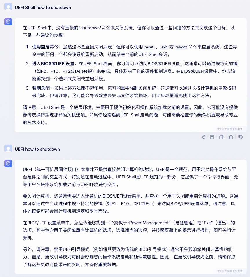

AI也没训练到这个问题:
还是问传统搜索:

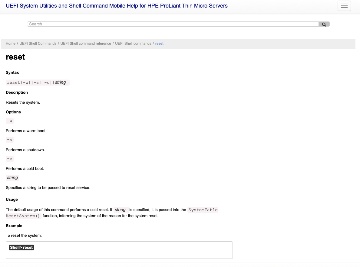

how to shutdown in UEFI shell

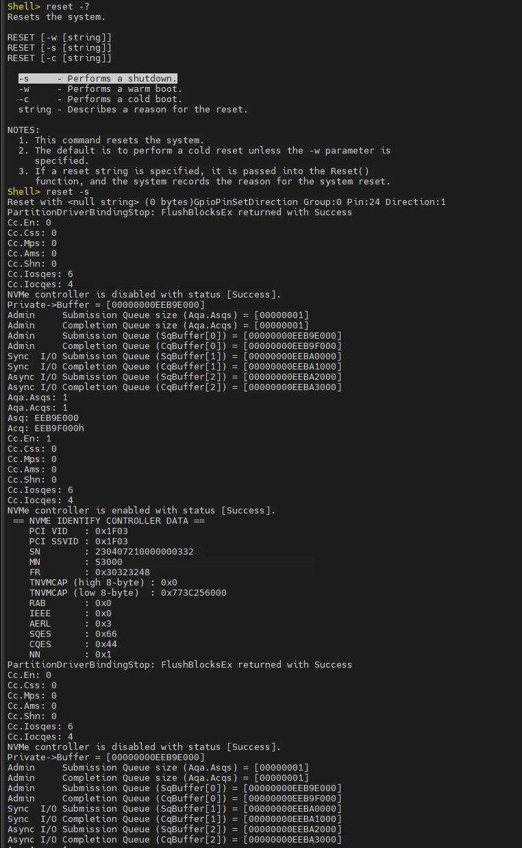

第一次从UEFI Shell 看到幽兰下电的log:
Shell> reset -?
Resets the system.
RESET [-w [string]]
RESET [-s [string]]
RESET [-c [string]]
  -s     - Performs a shutdown.
  -w     - Performs a warm boot.
  -c     - Performs a cold boot.
  string - Describes a reason for the reset.
NOTES:
  1. This command resets the system.
  2. The default is to perform a cold reset unless the -w parameter is
     specified.
  3. If a reset string is specified, it is passed into the Reset()
     function, and the system records the reason for the system reset.
Shell> reset -s
Reset with <null string> (0 bytes)GpioPinSetDirection Group:0 Pin:24 Direction:1

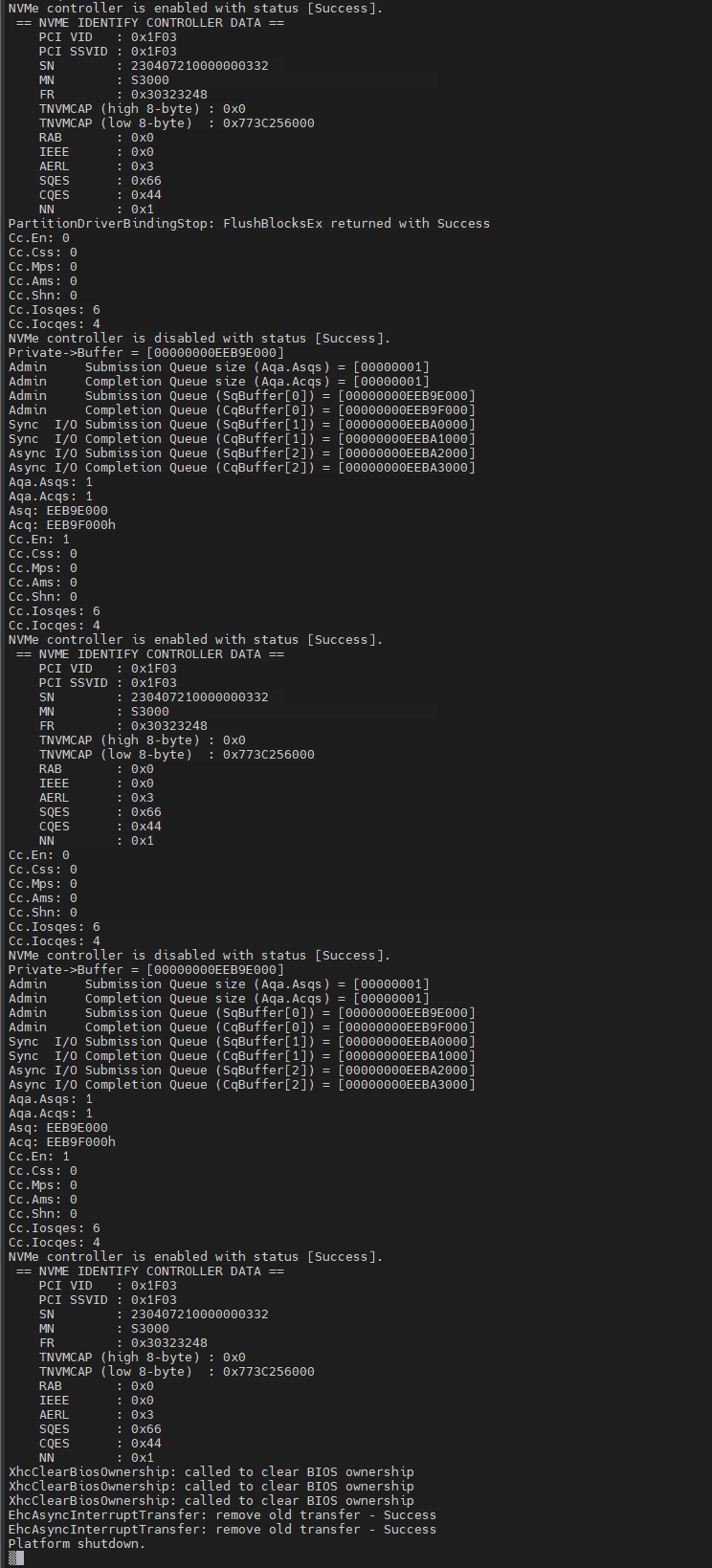

XhcClearBiosOwnership: called to clear BIOS ownership
EhcAsyncInterruptTransfer: remove old transfer - Success
Platform shutdown.
