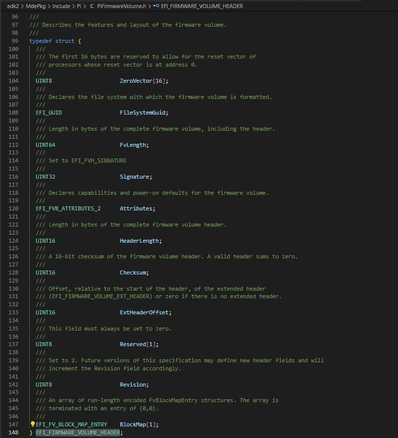

观察EFI_HOB_FIRMWARE_VOLUME
dt -b EFI_FIRMWARE_VOLUME_HEADER 200000

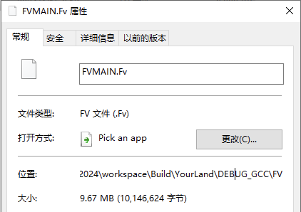

.formats 9ad340
eval expression:
  Hex:     00000000`009ad340
  Decimal: 10146624
  Octal:   0000000000000046551500
  Binary:  00000000 00000000 00000000 00000000 00000000 10011010 11010011 01000000
  Chars:   .......@
  Time:    Mon Jan  1 08:00:01.014 1601 (GMT+8)
  Float:   low 1.42184e-38 high 0
  Double:  5.0131e-317
dt -b EFI_FIRMWARE_VOLUME_HEADER 0`3ec71000
+0x020 FvLength : 0x9ad340
Decimal: 10146624

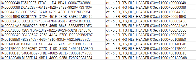

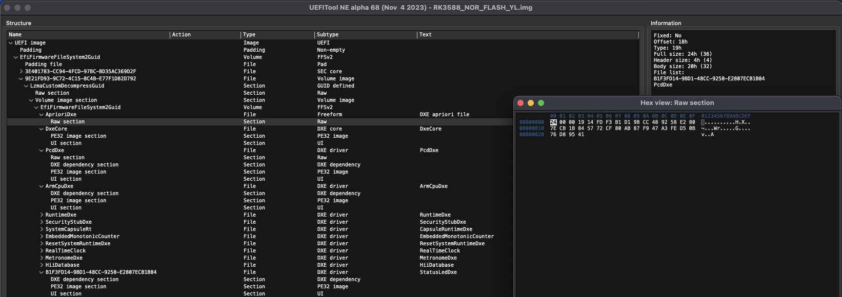

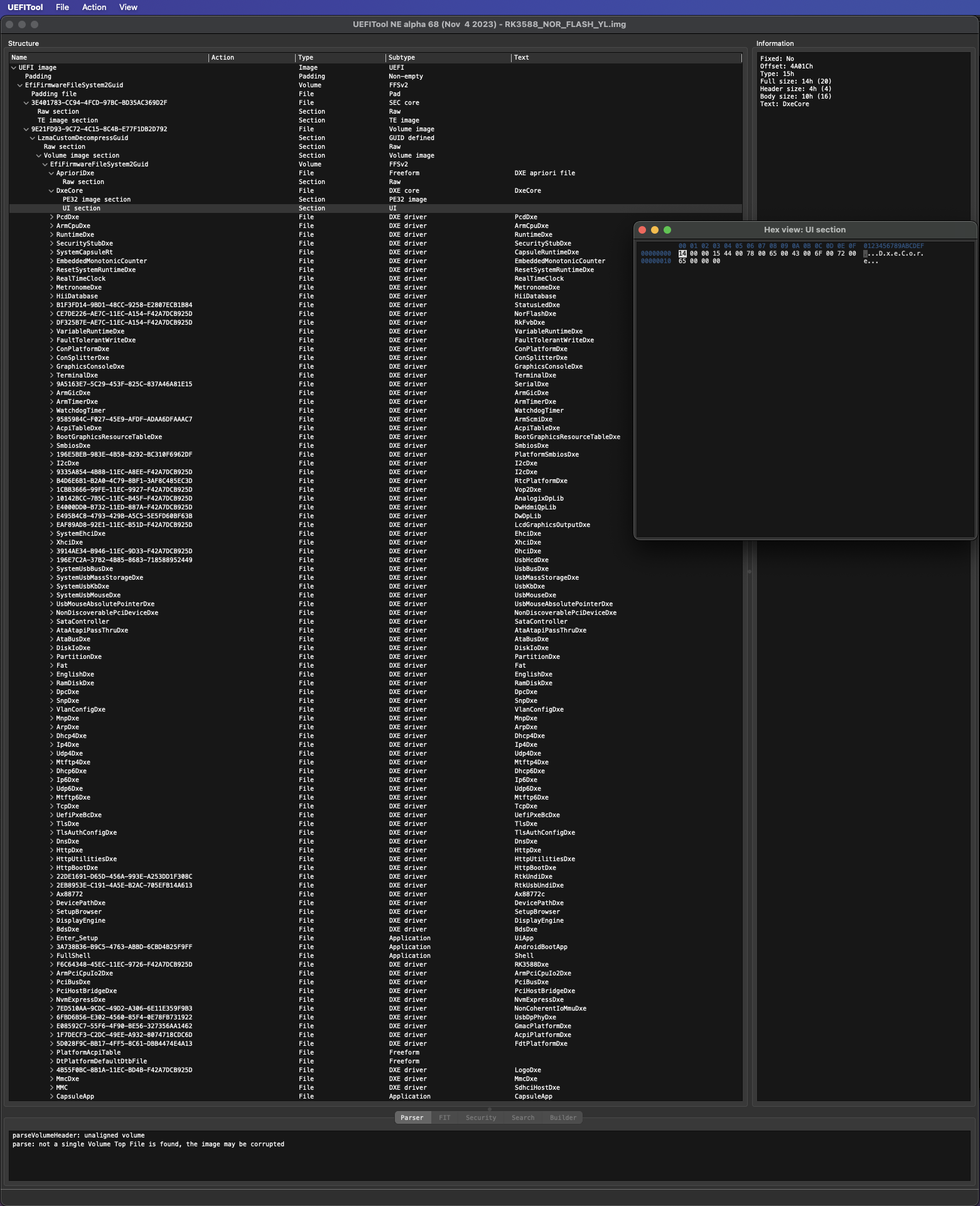

于是找到了加载到内存中的FVMAIN:
Excel生成一个脚本文件执行:
打印了每一个EFI_FFS_FILE_HEADER:
$<d:\gedu\uefi\dumpFVMAIN_EFI_FFS_FILE_HEADER.txt
kd> dt -b EFI_FFS_FILE_HEADER 0`3ec71000+00000048

FVMAIN.Fv 全局观:

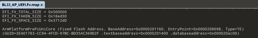

不在FVMAIN.Fv的其他Module:
ArmPlatformPrePiUniCore (Fixed Flash Address, BaseAddress=0x0000201160, EntryPoint=0x0000208698, Type=TE)
想找一下BL33_AP_UEFI的资料,用GUID 9E21FD93-9C72-4c15-8C4B-E77F1DB2D792搜了一下:
先找到:https://www.binarly.io/blog/the-dark-side-of-uefi-a-technical-deep-dive-into-cross-silicon-exploitation
再找到一个不错的工具:https://github.com/LongSoft/UEFITool/releases
UEFI一个更好的全局观浮现出来:
2024.05.03
有了工具的帮助,再来进一步拆解一下FVMAIN.Fv,先试第一个Firmware File, Freeform,内容包含两个Dxe的EFI_GUID:

dt -b EFI_FFS_FILE_HEADER 0`3ec71000+48
   +0x000 Name             :
      +0x000 Data1            : 0xfc510ee7
      +0x004 Data2            : 0xffdc
      +0x006 Data3            : 0x11d4
      +0x008 Data4            :
       [00] 0xbd ''
       [01] 0x41 'A'
       [02] 0 ''
       [03] 0x80 ''
       [04] 0xc7 ''
       [05] 0x3c '<'
       [06] 0x88 ''
       [07] 0x81 ''
   +0x010 IntegrityCheck   :
      +0x000 Checksum         :
         +0x000 Header           : 0x36 '6'
         +0x001 File             : 0xaa ''
      +0x000 Checksum16       : 0xaa36
   +0x012 Type             : 0x2 ''
   +0x013 Attributes       : 0 ''
   +0x014 Size             :
    [00] 0x3c '<'
    [01] 0 ''
    [02] 0 ''
   +0x017 State            : 0xf8 ''
   +0x000 ZeroVector       :
    [00] 0 ''
    [01] 0 ''
    [02] 0 ''
    [03] 0 ''
    [04] 0 ''
    [05] 0 ''
    [06] 0 ''
    [07] 0 ''
    [08] 0 ''
    [09] 0 ''
    [10] 0 ''
    [11] 0 ''
    [12] 0 ''
    [13] 0 ''
    [14] 0 ''
    [15] 0 ''
   +0x010 FileSystemGuid   :
      +0x000 Data1            : 0x8c8ce578
      +0x004 Data2            : 0x8a3d
      +0x006 Data3            : 0x4f1c
      +0x008 Data4            :
       [00] 0x99 ''
       [01] 0x35 '5'
       [02] 0x89 ''
       [03] 0x61 'a'
       [04] 0x85 ''
       [05] 0xc3 ''
       [06] 0x2d '-'
       [07] 0xd3 ''
   +0x028 Signature        : 0x4856465f
   +0x02c Attributes       : 0x3feff
   +0x030 HeaderLength     : 0x48
   +0x032 Checksum         : 0xb767
   +0x034 ExtHeaderOffset  : 0
   +0x036 Reserved         :
    [00] 0 ''
   +0x037 Revision         : 0x2 ''
   +0x038 BlockMap         :
    [00]
      +0x000 NumBlocks        : 0x26b4d
    +0x004 Length           : 0x40
[ndb]!echo "   +0x030 HeaderLength     : 0x48"
   +0x000 Name             :
      +0x008 Data4            :
       [00] 0xbd ''
       [01] 0x41 'A'
       [02] 0 ''
       [03] 0x80 ''
       [04] 0xc7 ''
       [05] 0x3c '<'
       [06] 0x88 ''
       [07] 0x81 ''
      +0x000 Checksum         :
   +0x014 Size             :
    [00] 0x3c '<'
    [01] 0 ''
    [02] 0 ''
[ndb]!echo "#define EFI_FV_FILETYPE_FREEFORM              0x02"
r $t0 = poi(0`3ec71000+48+14)
? $t0 & 00ffffff
eval expression: 60 = 00000000`0000003c
[ndb]!echo "This is size."
This is size.
?? sizeof(EFI_FFS_FILE_HEADER)
unsigned int64 0x18
db 0`3ec71000+48+18 l3c-18
00000000`3ec71060  24 00 00 19 14 fd f3 b1-d1 9b cc 48 92 58 e2 80  $..........H.X..
00000000`3ec71070  7e cb 1b 84 57 72 cf 80-ab 87 f9 47 a3 fe d5 0b  ~...Wr.....G....
00000000`3ec71080  76 d8 95 41                                      v..A
dt -b EFI_COMMON_SECTION_HEADER 0`3ec71000+48+18
   +0x000 Size             :
    [00] 0x24 '$'
    [01] 0 ''
    [02] 0 ''
   +0x003 Type             : 0x19 ''
[ndb]!echo "#define EFI_SECTION_RAW                   0x19"
dt EFI_GUID 0`3ec71000+48+18+4
   +0x000 Data1            : 0xb1f3fd14
   +0x004 Data2            : 0x9bd1
   +0x006 Data3            : 0x48cc
   +0x008 Data4            : [8]UINT8[] 0x92 ''
[ndb]!echo "b1f3fd14-9bd1-48cc-9258-e2807ecb1b84StatusLedDxe"
dt EFI_GUID 0`3ec71000+48+18+4+10
   +0x000 Data1            : 0x80cf7257
   +0x004 Data2            : 0x87ab
   +0x006 Data3            : 0x47f9
   +0x008 Data4            : [8]UINT8[] 0xa3 ''
[ndb]!echo "80CF7257-87AB-47f9-A3FE-D50B76D89541PcdDxe"
下一个,DxeCore (00000000`3ecbb0a8 “DxeCore”):
dt -b EFI_FFS_FILE_HEADER 0`3ec71000+88
   +0x000 Name             :
      +0x000 Data1            : 0xd6a2cb7f
      +0x004 Data2            : 0x6a18
      +0x006 Data3            : 0x4e2f
      +0x008 Data4            :
       [00] 0xb4 ''
       [01] 0x3b ';'
       [02] 0x99 ''
       [03] 0x20 ' '
       [04] 0xa7 ''
       [05] 0x33 '3'
       [06] 0x70 'p'
       [07] 0xa ''
      +0x000 Checksum         :
         +0x000 Header           : 0x6a 'j'
      +0x000 Checksum16       : 0xaa6a
   +0x012 Type             : 0x5 ''
   +0x014 Size             :
    [00] 0x30 '0'
    [01] 0xa0 ''
    [02] 0x4 ''
dt -b EFI_COMMON_SECTION_HEADER 0`3ec71000+88+18
   +0x000 Size             :
    [00] 0x4 ''
    [01] 0xa0 ''
    [02] 0x4 ''
   +0x003 Type             : 0x10 ''
r $t0=poi(0`3ec71000+88+18)
? $t0 & 00ffffff
eval expression: 303108 = 00000000`0004a004
db 0`3ec71000+88+18+4a004
00000000`3ecbb0a4  14 00 00 15 44 00 78 00-65 00 43 00 6f 00 72 00  ....D.x.e.C.o.r.
00000000`3ecbb0b4  65 00 00 00 57 72 cf 80-ab 87 f9 47 a3 fe d5 0b  e...Wr.....G....
00000000`3ecbb0c4  76 d8 95 41 f7 aa 07 00-2a a9 00 f8 e4 08 00 19  v..A....*.......
00000000`3ecbb0d4  3c 19 7d 3c 2c 68 14 4c-a6 8f 55 2d ea 4f 43 7e  <.}<,h.L..U-.OC~
00000000`3ecbb0e4  07 00 00 00 e0 08 00 00-00 00 00 00 00 00 00 00  ................
00000000`3ecbb0f4  e0 08 00 00 1b 00 00 00-04 01 00 00 dc 00 00 00  ................
00000000`3ecbb104  9c 01 00 00 38 04 00 00-d4 08 00 00 50 00 00 00  ....8.......P...
00000000`3ecbb114  00 00 00 00 26 00 05 00-04 00 da da da da da da  ....&...........
dt -b EFI_COMMON_SECTION_HEADER 0`3ec71000+88+18+4a004
   +0x000 Size             :
    [00] 0x14 ''
    [01] 0 ''
    [02] 0 ''
   +0x003 Type             : 0x15 ''
[ndb]!echo "#define EFI_SECTION_USER_INTERFACE        0x15"
du 0`3ec71000+88+18+4a004+4
00000000`3ecbb0a8  "DxeCore"
