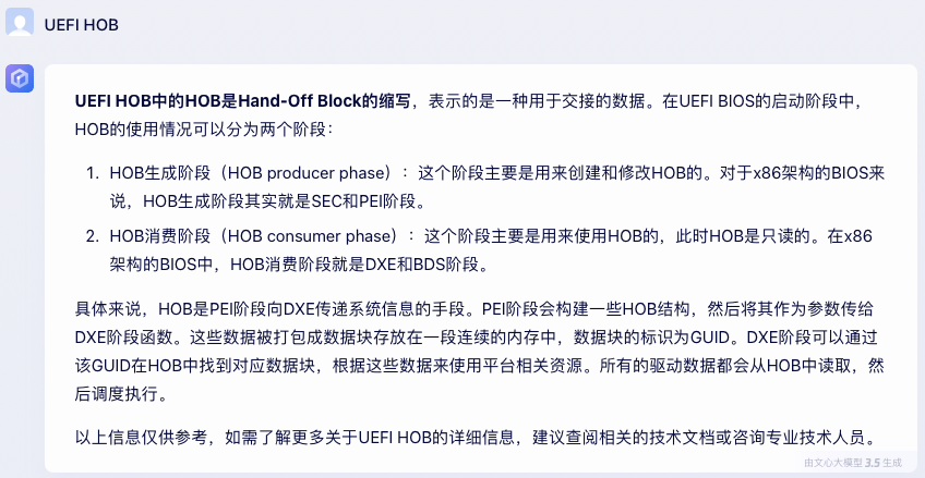

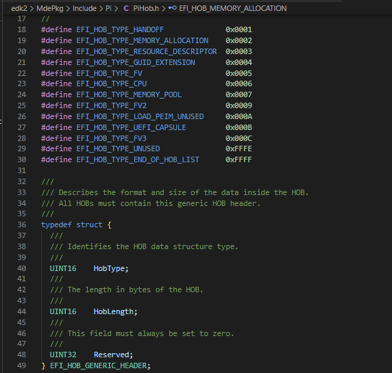

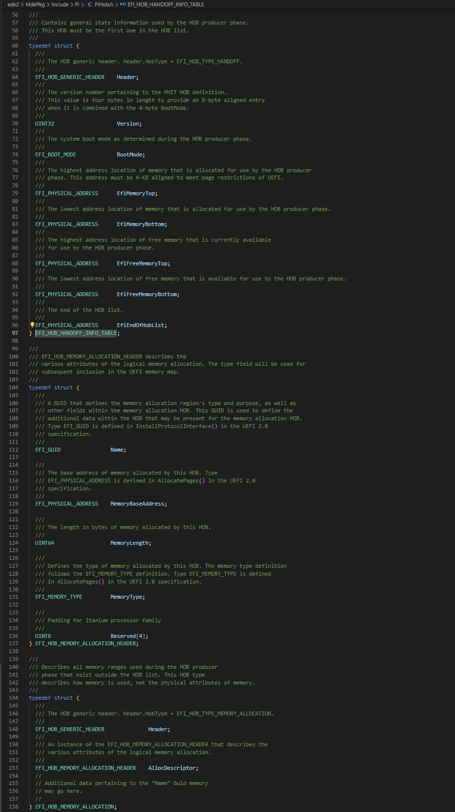

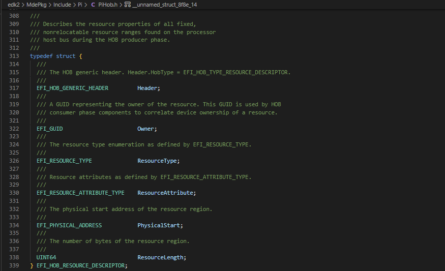

用NDB徒手解释完了整张mHobList,心中有数,命名HOB有道理:

dt -b EFI_HOB_GENERIC_HEADER 00000000`efdfd018
   +0x000 HobType          : 1
   +0x002 HobLength        : 0x38
   +0x004 Reserved         : 0
dt -b EFI_HOB_HANDOFF_INFO_TABLE 00000000`efdfd018
   +0x000 Header           :
      +0x000 HobType          : 1
      +0x004 Reserved         : 0
   +0x008 Version          : 9
   +0x00c BootMode         : 0
   +0x010 EfiMemoryTop     : 0x40000000
   +0x018 EfiMemoryBottom  : 0x38000000
   +0x020 EfiFreeMemoryTop : 0x3ec27000
   +0x028 EfiFreeMemoryBottom : 0x38000aa0
   +0x030 EfiEndOfHobList  : 0x38000a98
dt -b EFI_HOB_GENERIC_HEADER 00000000`efdfd018+38
   +0x000 HobType          : 2
   +0x002 HobLength        : 0x30
   +0x004 Reserved         : 0
dt -b EFI_HOB_MEMORY_ALLOCATION 00000000`efdfd018+38
   +0x000 Header           :
      +0x000 HobType          : 2
      +0x004 Reserved         : 0
   +0x008 AllocDescriptor  :
      +0x000 Name             :
         +0x000 Data1            : 0
         +0x004 Data2            : 0
         +0x006 Data3            : 0
         +0x008 Data4            :
          [00] 0 ''
          [01] 0 ''
          [02] 0 ''
          [03] 0 ''
          [04] 0 ''
          [05] 0 ''
          [06] 0 ''
          [07] 0 ''
      +0x010 MemoryBaseAddress : 0x3ffe8000
      +0x018 MemoryLength     : 0x1000
      +0x020 MemoryType       : 4 ( EfiBootServicesData )
      +0x024 Reserved         :
       [00] 0 ''
       [01] 0 ''
       [02] 0 ''
       [03] 0 ''

dt -b EFI_HOB_RESOURCE_DESCRIPTOR 00000000`efdfd018+38+30
   +0x000 Header           :
      +0x000 HobType          : 3
      +0x004 Reserved         : 0
   +0x008 Owner            :
      +0x000 Data1            : 0x10000
      +0x004 Data2            : 0
      +0x006 Data3            : 0x20
      +0x008 Data4            :
       [00] 0 ''
       [01] 0 ''
       [02] 0 ''
       [03] 0 ''
       [04] 0 ''
       [05] 0 ''
       [06] 0x40 '@'
       [07] 0 ''
   +0x018 ResourceType     : 0
   +0x01c ResourceAttribute : 0x3807
   +0x020 PhysicalStart    : 0
   +0x028 ResourceLength   : 0xf0000000

dt -b EFI_HOB_GENERIC_HEADER 00000000`efdfd018+38+30*10
   +0x000 HobType          : 2
   +0x004 Reserved         : 0
dt -b EFI_HOB_MEMORY_ALLOCATION 00000000`efdfd018+38+30*10
   +0x000 Header           :
      +0x000 HobType          : 2
      +0x004 Reserved         : 0
      +0x000 Name             :
         +0x000 Data1            : 0
         +0x004 Data2            : 0
         +0x006 Data3            : 0
         +0x008 Data4            :
          [00] 0 ''
          [01] 0 ''
          [02] 0 ''
          [03] 0 ''
          [04] 0 ''
          [05] 0 ''
          [06] 0 ''
          [07] 0 ''
      +0x010 MemoryBaseAddress : 0x3ffe6000
      +0x024 Reserved         :
       [00] 0 ''
       [01] 0 ''
       [02] 0 ''
       [03] 0 ''
dt -b EFI_HOB_GENERIC_HEADER 00000000`efdfd018+38+30*11
   +0x000 HobType          : 2
   +0x004 Reserved         : 0
dt -b EFI_HOB_MEMORY_ALLOCATION 00000000`efdfd018+38+30*11
   +0x000 Header           :
      +0x000 HobType          : 2
      +0x004 Reserved         : 0

dt -b EFI_HOB_GENERIC_HEADER 00000000`efdfd018+38+30*18
   +0x000 HobType          : 4
   +0x002 HobLength        : 0x68
   +0x004 Reserved         : 0
[ndb]!echo "#define EFI_HOB_TYPE_GUID_EXTENSION       0x0004"
?? sizeof(EFI_HOB_GUID_TYPE)
unsigned int64 0x18

dt -b EFI_HOB_MEMORY_ALLOCATION 00000000`efdfd018+38+30*18+68
   +0x000 Header           :
      +0x000 HobType          : 2
      +0x004 Reserved         : 0
      +0x000 Name             :
         +0x000 Data1            : 0x4ed4bf27
         +0x004 Data2            : 0x4092
         +0x006 Data3            : 0x42e9
         +0x008 Data4            :
          [00] 0x80 ''
          [01] 0x7d '}'
          [02] 0x52 'R'
          [03] 0x7b '{'
          [04] 0x1d ''
          [05] 0 ''
          [06] 0xc9 ''
          [07] 0xbd ''
      +0x010 MemoryBaseAddress : 0x3ffe9000
      +0x018 MemoryLength     : 0x17000
      +0x024 Reserved         :
       [00] 0 ''
       [01] 0 ''
       [02] 0 ''
       [03] 0 ''
dt -b EFI_HOB_GENERIC_HEADER 00000000`efdfd018+38+30*18+68+30
   +0x000 HobType          : 6
   +0x002 HobLength        : 0x10
   +0x004 Reserved         : 0
[ndb]!echo "#define EFI_HOB_TYPE_CPU                  0x0006"
?? sizeof(EFI_HOB_CPU)
unsigned int64 0x10

dt -b EFI_HOB_GENERIC_HEADER 00000000`efdfd018+38+30*18+68+30+10+158+20
   +0x000 HobType          : 5
   +0x002 HobLength        : 0x18
   +0x004 Reserved         : 0
[ndb]!echo "#define EFI_HOB_TYPE_FV                   0x0005"
dt -b EFI_HOB_TYPE_FV 00000000`efdfd018+38+30*18+68+30+10+158+20
critical symbol information is absent. a lot of features are affected.
Symbol EFI_HOB_TYPE_FV not found.
dt -b EFI_HOB_FIRMWARE_VOLUME 00000000`efdfd018+38+30*18+68+30+10+158+20
   +0x000 Header           :
      +0x000 HobType          : 5
      +0x004 Reserved         : 0
   +0x008 BaseAddress      : 0x200000
   +0x010 Length           : 0x500000
dt -b EFI_HOB_GENERIC_HEADER 00000000`efdfd018+38+30*18+68+30+10+158+20+18
   +0x000 HobType          : 7
   +0x002 HobLength        : 0x108
   +0x004 Reserved         : 0
[ndb]!echo "#define EFI_HOB_TYPE_MEMORY_POOL          0x0007"
dt -b EFI_HOB_MEMORY_POOL 00000000`efdfd018+38+30*18+68+30+10+158+20+18
   +0x000 Header           :
      +0x000 HobType          : 7
      +0x004 Reserved         : 0

dt -b EFI_HOB_GENERIC_HEADER 00000000`efdfd018+38+30*18+68+30+10+158+20+18+108
   +0x000 HobType          : 7
   +0x002 HobLength        : 0x88
   +0x004 Reserved         : 0

dt -b EFI_HOB_GENERIC_HEADER 00000000`efdfd018+38+30*18+68+30+10+158+20+18+108+88
   +0x000 HobType          : 7
   +0x004 Reserved         : 0

dt -b EFI_HOB_GENERIC_HEADER 00000000`efdfd018+38+30*18+68+30+10+158+20+18+108+88*2
   +0x000 HobType          : 4
   +0x004 Reserved         : 0

dt -b EFI_HOB_GENERIC_HEADER 00000000`efdfd018+38+30*18+68+30+10+158+20+18+108+88*2+38
   +0x000 HobType          : 2
   +0x004 Reserved         : 0
dt -b EFI_HOB_MEMORY_ALLOCATION 00000000`efdfd018+38+30*18+68+30+10+158+20+18+108+88*2+38
   +0x000 Header           :
      +0x000 HobType          : 2
      +0x004 Reserved         : 0
      +0x000 Name             :
         +0x000 Data1            : 0
         +0x004 Data2            : 0
         +0x006 Data3            : 0
         +0x008 Data4            :
          [00] 0 ''
          [01] 0 ''
          [02] 0 ''
          [03] 0 ''
          [04] 0 ''
          [05] 0 ''
          [06] 0 ''
          [07] 0 ''
      +0x010 MemoryBaseAddress : 0x3ffcf000
      +0x018 MemoryLength     : 0x10000
      +0x024 Reserved         :
       [00] 0 ''
       [01] 0 ''
       [02] 0 ''
       [03] 0 ''

dt -b EFI_HOB_GENERIC_HEADER 00000000`efdfd018+38+30*18+68+30+10+158+20+18+108+88*2+38+30
   +0x000 HobType          : 2
   +0x004 Reserved         : 0
dt -b EFI_HOB_MEMORY_ALLOCATION 00000000`efdfd018+38+30*18+68+30+10+158+20+18+108+88*2+38+30
   +0x000 Header           :
      +0x000 HobType          : 2
      +0x004 Reserved         : 0
      +0x000 Name             :
         +0x000 Data1            : 0
         +0x004 Data2            : 0
         +0x006 Data3            : 0
         +0x008 Data4            :
          [00] 0 ''
          [01] 0 ''
          [02] 0 ''
          [03] 0 ''
          [04] 0 ''
          [05] 0 ''
          [06] 0 ''
          [07] 0 ''
      +0x010 MemoryBaseAddress : 0x3f620000
      +0x018 MemoryLength     : 0x9af000
      +0x024 Reserved         :
       [00] 0 ''
       [01] 0 ''
       [02] 0 ''
       [03] 0 ''
dt -b EFI_HOB_GENERIC_HEADER 00000000`efdfd018+38+30*18+68+30+10+158+20+18+108+88*2+38+30*2
   +0x000 HobType          : 2
   +0x004 Reserved         : 0
dt -b EFI_HOB_MEMORY_ALLOCATION 00000000`efdfd018+38+30*18+68+30+10+158+20+18+108+88*2+38+30*2
   +0x000 Header           :
      +0x000 HobType          : 2
      +0x004 Reserved         : 0
      +0x000 Name             :
         +0x000 Data1            : 0
         +0x004 Data2            : 0
         +0x006 Data3            : 0
         +0x008 Data4            :

dt -b EFI_HOB_GENERIC_HEADER 00000000`efdfd018+38+30*18+68+30+10+158+20+18+108+88*2+38+30*3
   +0x000 HobType          : 5
   +0x004 Reserved         : 0
dt -b EFI_HOB_FIRMWARE_VOLUME 00000000`efdfd018+38+30*18+68+30+10+158+20+18+108+88*2+38+30*3
   +0x000 Header           :
      +0x000 HobType          : 5
      +0x004 Reserved         : 0
   +0x008 BaseAddress      : 0x3ec71000
   +0x010 Length           : 0x9ad340
dt -b EFI_HOB_GENERIC_HEADER 00000000`efdfd018+38+30*18+68+30+10+158+20+18+108+88*2+38+30*3+18
   +0x000 HobType          : 9
   +0x004 Reserved         : 0
[ndb]!echo "#define EFI_HOB_TYPE_FV2                  0x0009"

dt -b EFI_HOB_GENERIC_HEADER 00000000`efdfd018+38+30*18+68+30+10+158+20+18+108+88*2+38+30*3+18+38
   +0x000 HobType          : 2
   +0x004 Reserved         : 0
dt -b EFI_HOB_MEMORY_ALLOCATION 00000000`efdfd018+38+30*18+68+30+10+158+20+18+108+88*2+38+30*3+18+38
   +0x000 Header           :
      +0x000 HobType          : 2
      +0x004 Reserved         : 0
      +0x000 Name             :
         +0x000 Data1            : 0
         +0x004 Data2            : 0
         +0x006 Data3            : 0
         +0x008 Data4            :
          [00] 0 ''
          [01] 0 ''
          [02] 0 ''
          [03] 0 ''
          [04] 0 ''
          [05] 0 ''
          [06] 0 ''
          [07] 0 ''
      +0x010 MemoryBaseAddress : 0x3ec27000
      +0x018 MemoryLength     : 0x4a000
      +0x020 MemoryType       : 3 ( EfiBootServicesCode )
      +0x024 Reserved         :
       [00] 0 ''
       [01] 0 ''
       [02] 0 ''
       [03] 0 ''
dt -b EFI_HOB_GENERIC_HEADER 00000000`efdfd018+38+30*18+68+30+10+158+20+18+108+88*2+38+30*3+18+38+30
   +0x000 HobType          : 2
   +0x002 HobLength        : 0x48
   +0x004 Reserved         : 0
dt -b EFI_HOB_MEMORY_ALLOCATION 00000000`efdfd018+38+30*18+68+30+10+158+20+18+108+88*2+38+30*3+18+38+30
   +0x000 Header           :
      +0x000 HobType          : 2
      +0x004 Reserved         : 0
      +0x000 Name             :
         +0x000 Data1            : 0xf8e21975
         +0x004 Data2            : 0x899
         +0x006 Data3            : 0x4f58
         +0x008 Data4            :
          [00] 0xa4 ''
          [01] 0xbe ''
          [02] 0x55 'U'
          [03] 0x25 ''
          [04] 0xa9 ''
          [05] 0xc6 ''
          [06] 0xd7 ''
          [07] 0x7a 'z'
      +0x024 Reserved         :
       [00] 0 ''
       [01] 0 ''
       [02] 0 ''
       [03] 0 ''
db 00000000`efdfd018+38+30*18+68+30+10+158+20+18+108+88*2+38+30*3+18+38+30 l48
00000000`efdfda68  02 00 48 00 00 00 00 00-75 19 e2 f8 99 08 58 4f  ..H.....u.....XO
00000000`efdfda78  a4 be 55 25 a9 c6 d7 7a-00 70 c2 3e 00 00 00 00  ..U%...z.p.>....
00000000`efdfda88  00 a0 04 00 00 00 00 00-03 00 00 00 00 00 00 00  ................
00000000`efdfda98  7f cb a2 d6 18 6a 2f 4e-b4 3b 99 20 a7 33 70 0a  .....j/N.;. .3p.
00000000`efdfdaa8  c8 20 c3 3e 00 00 00 00                          . .>....
dqs 00000000`efdfd018+38+30*18+68+30+10+158+20+18+108+88*2+38+30*3+18+38+30 l48/8
00000000`efdfda68  00000000`00480002
00000000`efdfda70  4f580899`f8e21975
00000000`efdfda78  7ad7c6a9`2555bea4
00000000`efdfda80  00000000`3ec27000 DxeCore!SwitchStack.obj+0x3ec27000
00000000`efdfda88  00000000`0004a000
00000000`efdfda90  00000000`00000003
00000000`efdfda98  4e2f6a18`d6a2cb7f
00000000`efdfdaa0  0a7033a7`20993bb4
00000000`efdfdaa8  00000000`3ec320c8 DxeCore!_ModuleEntryPoint
dt -b EFI_HOB_GENERIC_HEADER 00000000`efdfd018+38+30*18+68+30+10+158+20+18+108+88*2+38+30*3+18+38+30+48
   +0x000 HobType          : 0xffff
   +0x002 HobLength        : 8
   +0x004 Reserved         : 0
[ndb]!echo "#define EFI_HOB_TYPE_END_OF_HOB_LIST      0xFFFF"
