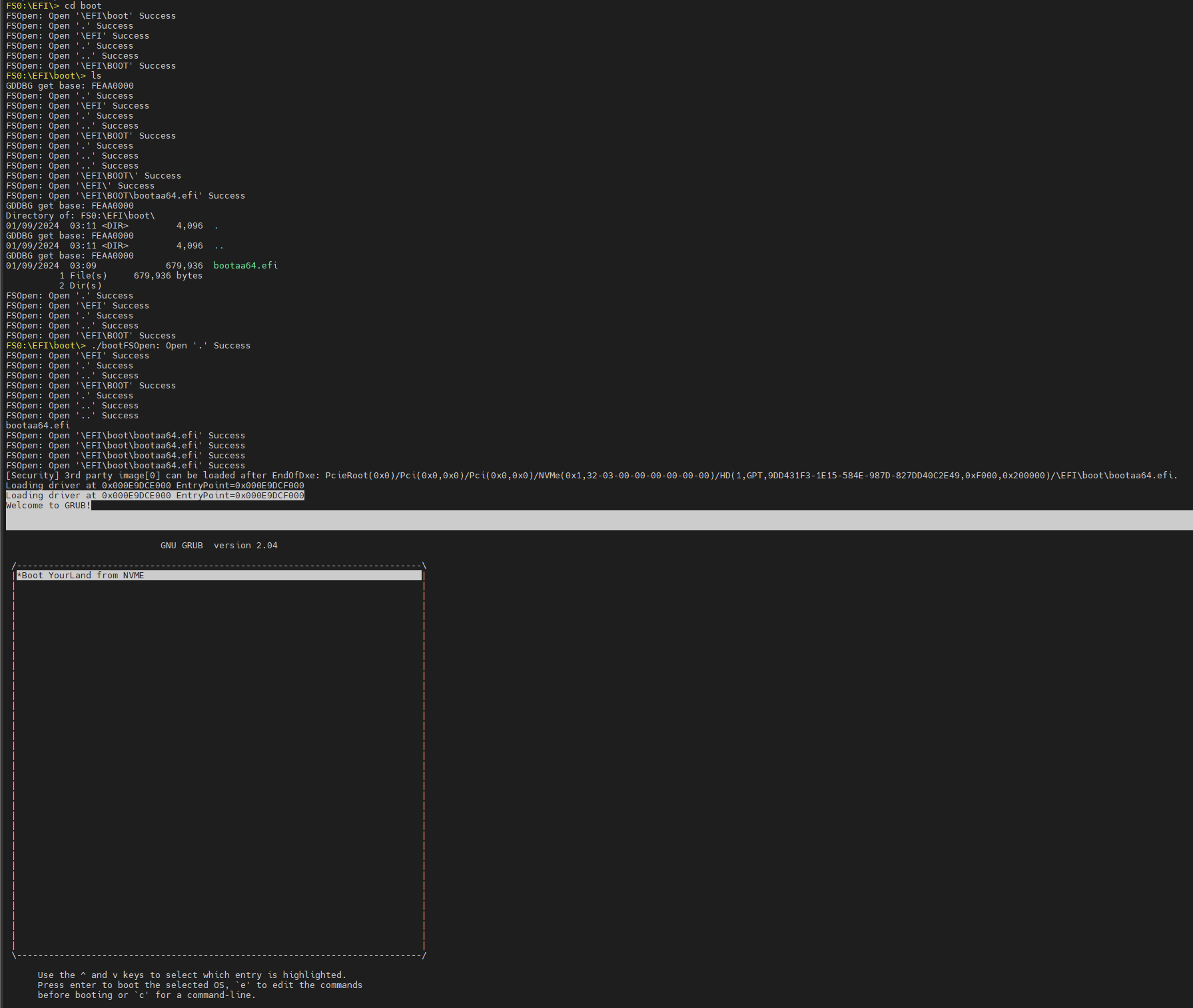

FS0:\EFI\> cd BOOT
FSOpen: Open '\EFI\BOOT' Success
FSOpen: Open '.' Success
FSOpen: Open '\EFI' Success
FSOpen: Open '..' Success
FS0:\EFI\BOOT\> ls
GDDBG get base: FEAA0000
FSOpen: Open '\EFI\BOOT\' Success
FSOpen: Open '\EFI\' Success
FSOpen: Open '\EFI\BOOT\bootaa64.efi' Success
Directory of: FS0:\EFI\BOOT\
01/09/2024  03:11 <DIR>         4,096  .
01/09/2024  03:11 <DIR>         4,096  ..
01/09/2024  03:09             679,936  bootaa64.efi
          1 File(s)     679,936 bytes
          2 Dir(s)
FS0:\EFI\BOOT\> cd ..
FS0:\EFI\> cd ..
FSOpen: Open '\' Success
FS0:\> cd ..
FS0:\> tree .
'tree' is not recognized as an internal or external command, operable program, o
r script file.

FS0:\grub\> ls
FSOpen: Open '\grub' Success
FSOpen: Open '\grub\' Success
FSOpen: Open '\grub\grub.cfg' Success
Directory of: FS0:\grub\
01/09/2024  03:11 <DIR>             0  ..
01/09/2024  03:10                 382  grub.cfg
          1 File(s)         382 bytes
          2 Dir(s)
FS0:\grub\> cat grub.cfg
set debug="loader,mm"
set term="vt100"
set default="0"
set timeout="1"
search --set=root --fs-uuid 91F3-6896
menuentry 'Boot YourLand from NVME' {
        linux /Image resume=UUID=8550cf7b-fb7e-475d-b7ca-e0140b91284c root=PARTU
UID=8dee4da3-bb01-d348-8c62-188b9c031ac1 noresume psi=1 splash label=debug rootw
ait verbose debug nokaslr
.initrd /initrd.img-5.10.110-rockchip-rk3588
FS0:\grub\> cd ..
FS0:\> cd ..
FS0:\> ls
FSOpen: Open '\Image' Success
FSOpen: Open '\System.map-5.10.110-rockchip-rk3588' Success
FSOpen: Open '\config-5.10.110-rockchip-rk3588' Success
FSOpen: Open '\initrd.img-5.10.110-rockchip-rk3588' Success
FSOpen: Open '\vmlinuz-5.10.110-rockchip-rk3588' Success
Directory of: FS0:\
01/09/2024  02:45             209,823  config-5.10.110-rockchip-rk3588
12/04/2023  07:24 <DIR>         4,096  EFI
01/09/2024  03:10 <DIR>         4,096  grub
01/09/2024  03:09          56,613,376  Image
01/09/2024  03:12           9,159,168  initrd.img-5.10.110-rockchip-rk3588
01/09/2024  02:45           8,108,572  System.map-5.10.110-rockchip-rk3588
01/09/2024  02:45          21,284,899  vmlinuz-5.10.110-rockchip-rk3588
          5 File(s)  95,375,838 bytes
          2 Dir(s)
FS0:\> cd EFFSOpen: Open '.' Success
EFI
FS0:\EFI\> LS
12/04/2023  07:24 <DIR>         4,096  BOOT
          0 File(s)           0 bytes
          3 Dir(s)
FS0:\EFI\> cd boot
FSOpen: Open '\EFI\boot' Success
FS0:\EFI\boot\> ls
Directory of: FS0:\EFI\boot\
          2 Dir(s)
FS0:\EFI\boot\> ./bootFSOpen: Open '.' Success
bootaa64.efi
FSOpen: Open '\EFI\boot\bootaa64.efi' Success
[Security] 3rd party image[0] can be loaded after EndOfDxe: PcieRoot(0x0)/Pci(0x0,0x0)/Pci(0x0,0x0)/NVMe(0x1,32-03-00-00-00-00-00-00)/HD(1,GPT,9DD431F3-1E15-584E-987D-827DD40C2E49,0xF000,0x200000)/\EFI\boot\bootaa64.efi.
Loading driver at 0x000E9DCE000 EntryPoint=0x000E9DCF000
Welcome to GRUB!
                             GNU GRUB  version 2.04
 |*Boot YourLand from NVME                                                    |
      Use the ^ and v keys to select which entry is highlighted.
      Press enter to boot the selected OS, `e' to edit the commands
      before booting or `c' for a command-line.

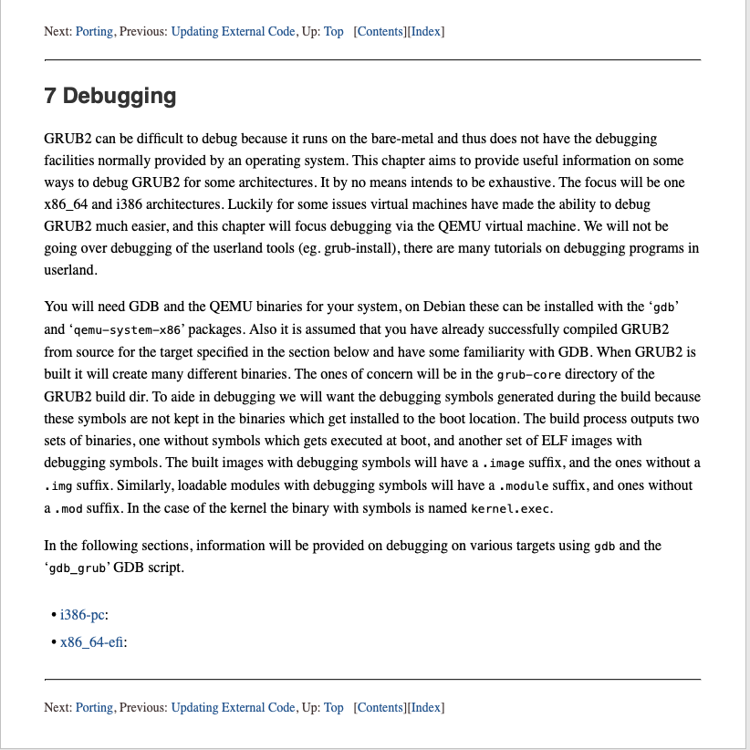

https://www.gnu.org/software/grub/manual/grub-dev/html_node/Debugging.html
GRUB2 can be difficult to debug because it runs on the bare-metal and thus does not have the debugging facilities normally provided by an operating system.
调试对GRUB2来说,已经是自然而然的事。
因为GRUB2,对于UEFI来说,也就是个被加载的Module,NDB真的已经很赞,可以期待更美好。
