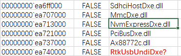

继续深挖下去,其实还有一些modules没有被列出来:

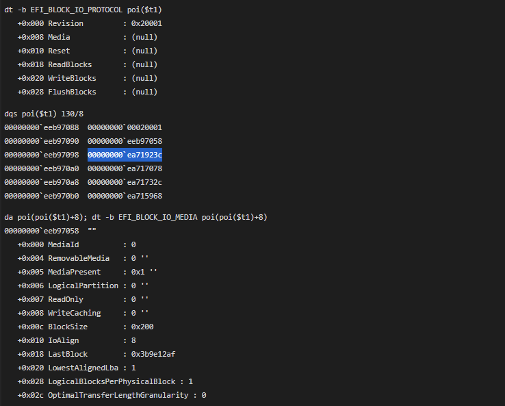

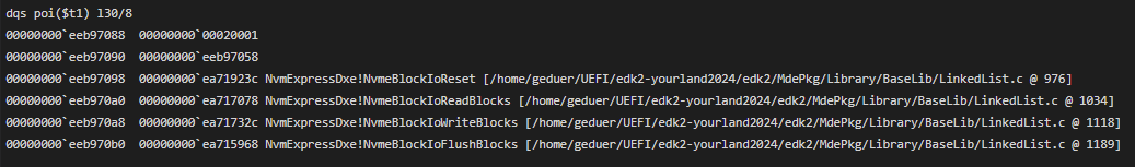

学习观察dblk时发现EFI_BLOCK_READ 没有符号,这应该有问题:
找了好一阵,终于想起前些天追查到的lm的新缺失,按地址应该是 NvmExpressDxe:
参阅:NDB lm命令实现的猜想
Bingo, so happy with the powerful NDB.

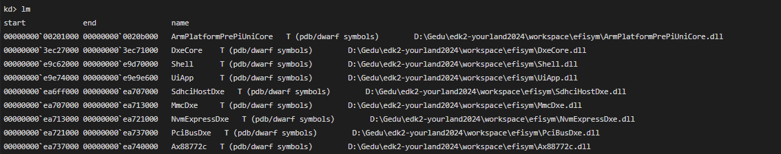

新的lm输出:

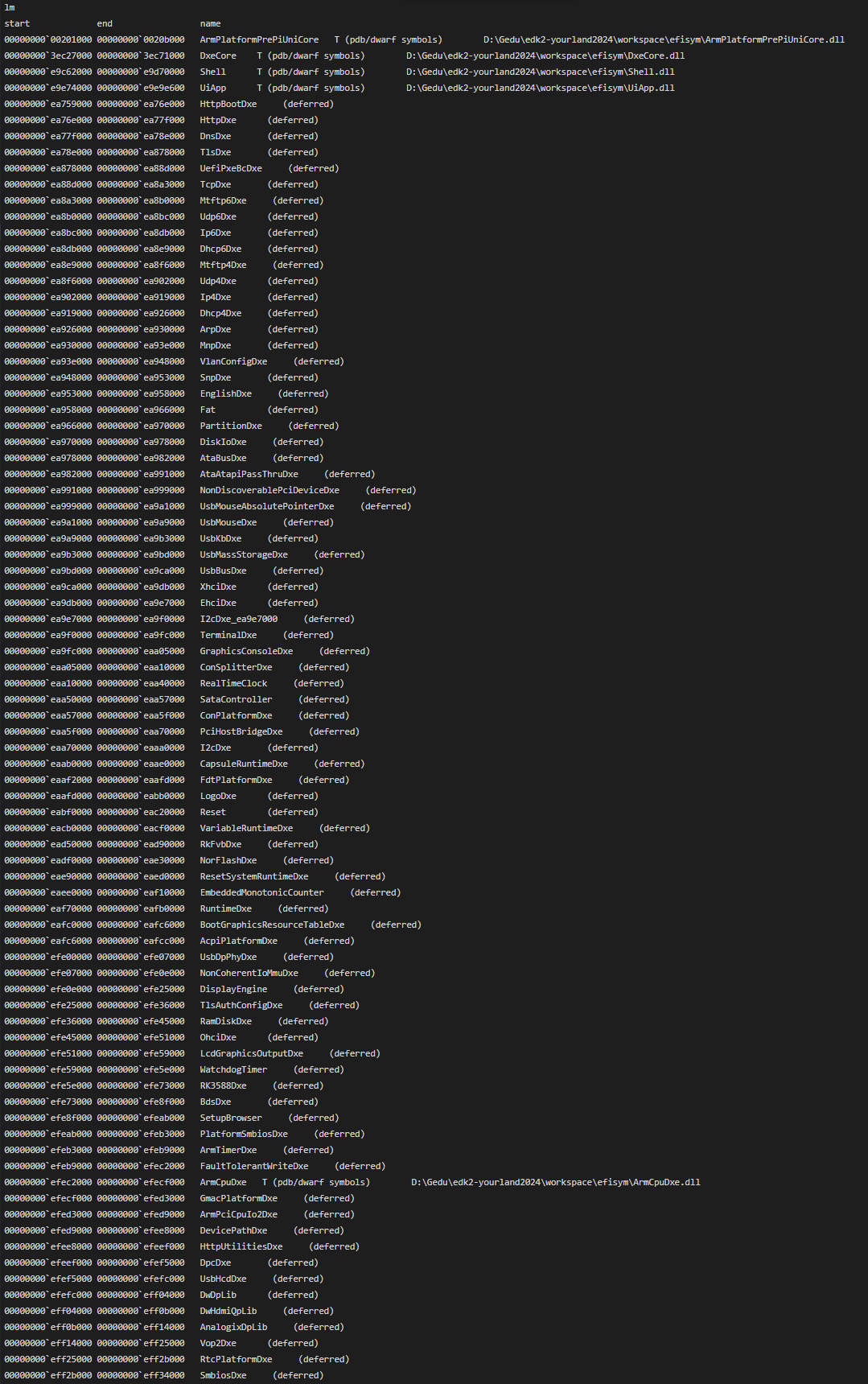

kd> lm
start             end                 name
00000000`00201000 00000000`0020b000   ArmPlatformPrePiUniCore   T (pdb/dwarf symbols)        D:\Gedu\edk2-yourland2024\workspace\efisym\ArmPlatformPrePiUniCore.dll
00000000`3ec27000 00000000`3ec71000   DxeCore    T (pdb/dwarf symbols)        D:\Gedu\edk2-yourland2024\workspace\efisym\DxeCore.dll
00000000`e9c62000 00000000`e9d70000   Shell      T (pdb/dwarf symbols)        D:\Gedu\edk2-yourland2024\workspace\efisym\Shell.dll
00000000`e9e74000 00000000`e9e9e600   UiApp      T (pdb/dwarf symbols)        D:\Gedu\edk2-yourland2024\workspace\efisym\UiApp.dll
00000000`ea6ff000 00000000`ea707000   SdhciHostDxe   T (pdb/dwarf symbols)        D:\Gedu\edk2-yourland2024\workspace\efisym\SdhciHostDxe.dll
00000000`ea707000 00000000`ea713000   MmcDxe     T (pdb/dwarf symbols)        D:\Gedu\edk2-yourland2024\workspace\efisym\MmcDxe.dll
00000000`ea713000 00000000`ea721000   NvmExpressDxe   T (pdb/dwarf symbols)        D:\Gedu\edk2-yourland2024\workspace\efisym\NvmExpressDxe.dll
00000000`ea721000 00000000`ea737000   PciBusDxe   T (pdb/dwarf symbols)        D:\Gedu\edk2-yourland2024\workspace\efisym\PciBusDxe.dll
00000000`ea737000 00000000`ea740000   Ax88772c   T (pdb/dwarf symbols)        D:\Gedu\edk2-yourland2024\workspace\efisym\Ax88772c.dll

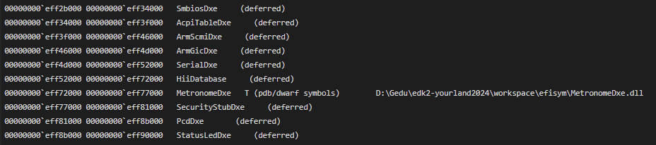

00000000`efec2000 00000000`efecf000   ArmCpuDxe   T (pdb/dwarf symbols)        D:\Gedu\edk2-yourland2024\workspace\efisym\ArmCpuDxe.dll
00000000`efecf000 00000000`efed3000   GmacPlatformDxe     (deferred)
00000000`efed3000 00000000`efed9000   ArmPciCpuIo2Dxe     (deferred)
00000000`efed9000 00000000`efee8000   DevicePathDxe     (deferred)
00000000`efee8000 00000000`efeef000   HttpUtilitiesDxe     (deferred)
00000000`efeef000 00000000`efef5000   DpcDxe       (deferred)
00000000`efef5000 00000000`efefc000   UsbHcdDxe     (deferred)
00000000`efefc000 00000000`eff04000   DwDpLib      (deferred)
00000000`eff04000 00000000`eff0b000   DwHdmiQpLib     (deferred)
00000000`eff0b000 00000000`eff14000   AnalogixDpLib     (deferred)
00000000`eff14000 00000000`eff25000   Vop2Dxe      (deferred)
00000000`eff25000 00000000`eff2b000   RtcPlatformDxe     (deferred)
00000000`eff2b000 00000000`eff34000   SmbiosDxe     (deferred)
00000000`eff34000 00000000`eff3f000   AcpiTableDxe     (deferred)
00000000`eff3f000 00000000`eff46000   ArmScmiDxe     (deferred)
00000000`eff46000 00000000`eff4d000   ArmGicDxe     (deferred)
00000000`eff4d000 00000000`eff52000   SerialDxe     (deferred)
00000000`eff52000 00000000`eff72000   HiiDatabase     (deferred)
00000000`eff72000 00000000`eff77000   MetronomeDxe     (deferred)
00000000`eff77000 00000000`eff81000   SecurityStubDxe     (deferred)
00000000`eff81000 00000000`eff8b000   PcdDxe       (deferred)
00000000`eff8b000 00000000`eff90000   StatusLedDxe     (deferred)
漂亮的输出结果:
通过lm这一条线索追下去,也可以学到不少的知识。
