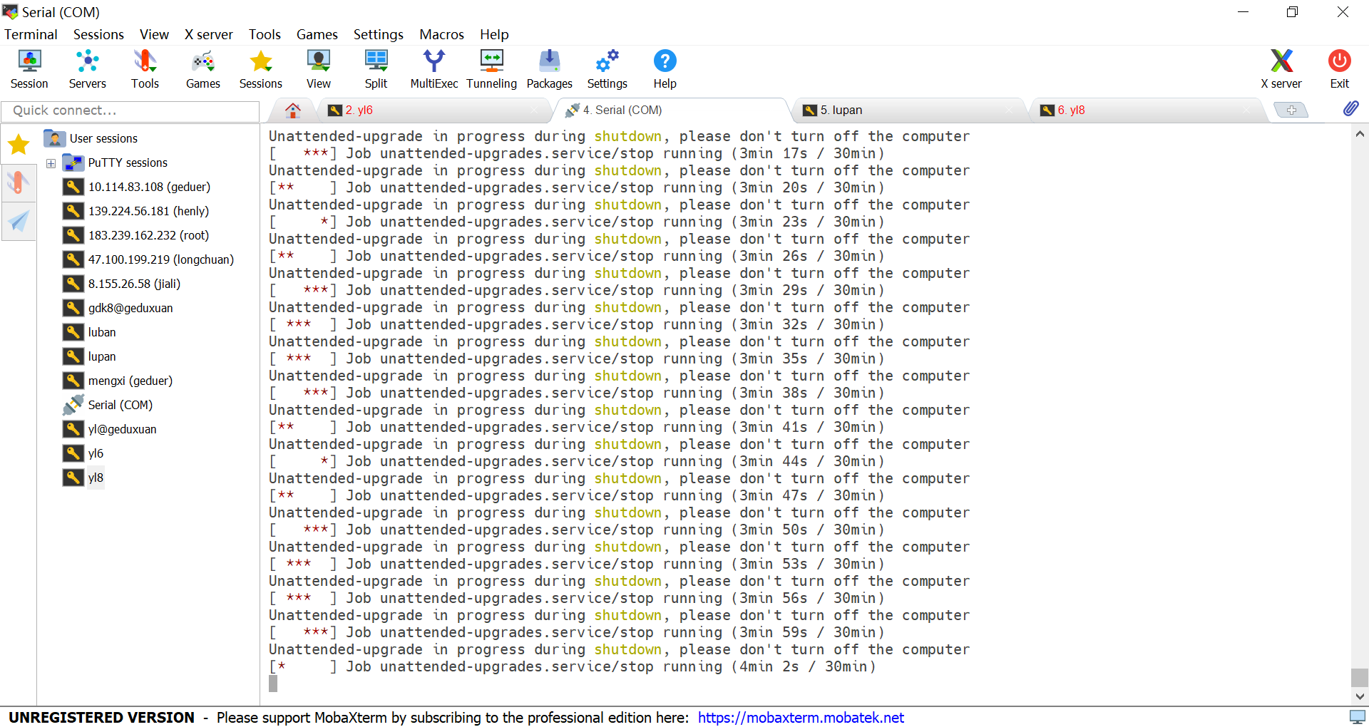

  3. 连上幽兰的串口套件,收到很多调试信息:
    c
    Unattended-upgrade in progress during shutdown, please don’t turn off the computer
    [ * ] Job unattended-upgrades.service/stop running (4min 38s / 30min)
    ] Job unattended-upgrades.service/stop running (4min 41s / 30min)
    [** ] Job unattended-upgrades.service/stop running (4min 44s / 30min)
    [ ] Job unattended-upgrades.service/stop running (4min 47s / 30min)
    ] Job unattended-upgrades.service/stop running (4min 50s / 30min)
    [ *] Job unattended-upgrades.service/stop running (4min 53s / 30min)
    ] Job unattended-upgrades.service/stop running (4min 56s / 30min)
    [ *** ] Job unattended-upgrades.service/stop running (4min 59s / 30min)
看起来是Ubuntu的后台自动升级服务阻碍了重启流程,在收到重启通知后,迟迟没有退出。
明确知道原因后,我一边写这篇短文,一边等了一会,系统便继续重启了。看来没有卡死,只是被耽搁了一阵子。
